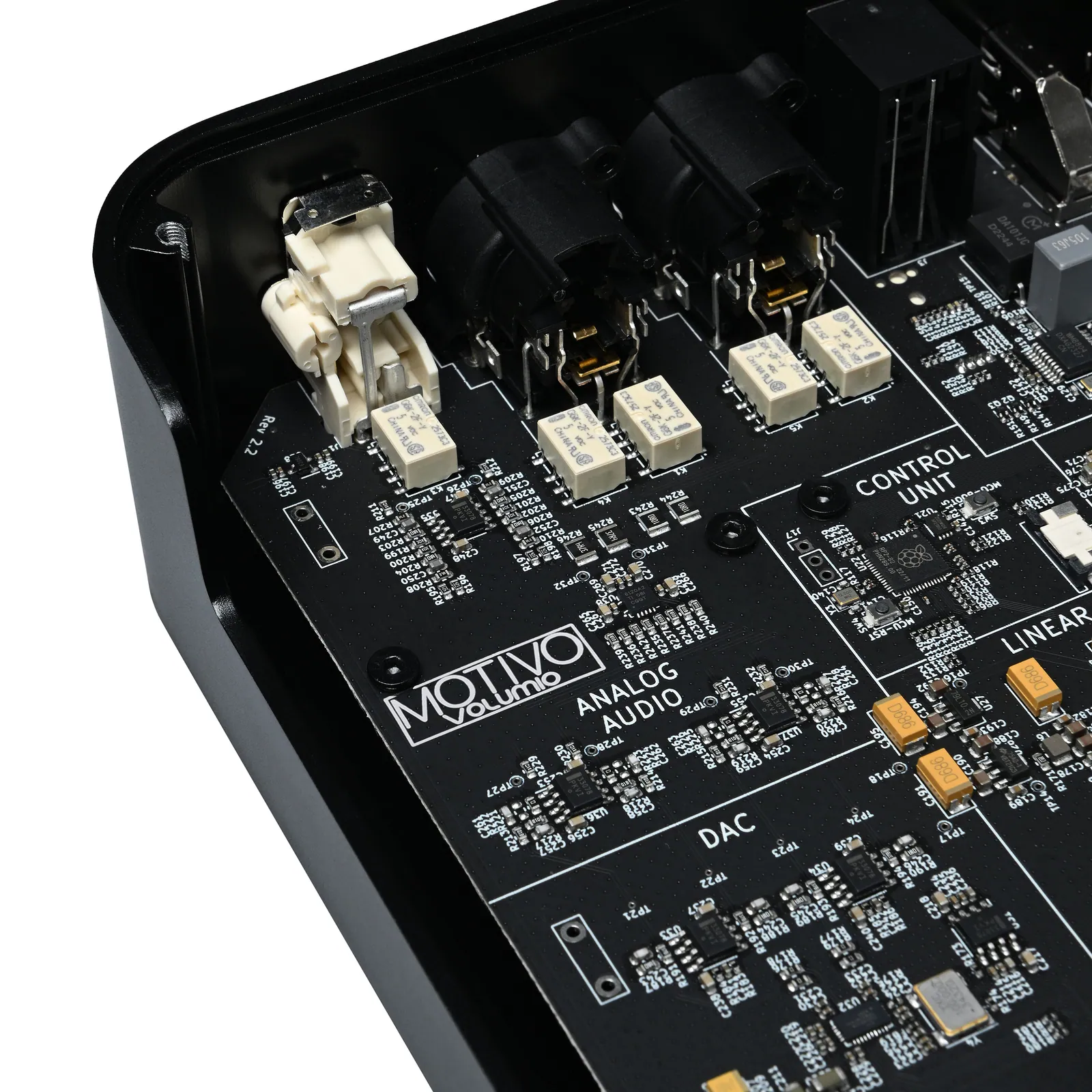

Close-up of the Motivo board behind the XLR outputs, with the Motivo name printed next to the analog audio, DAC, control unit and linear supply sections.
The analog audio and DAC sections, behind the XLR outputs.

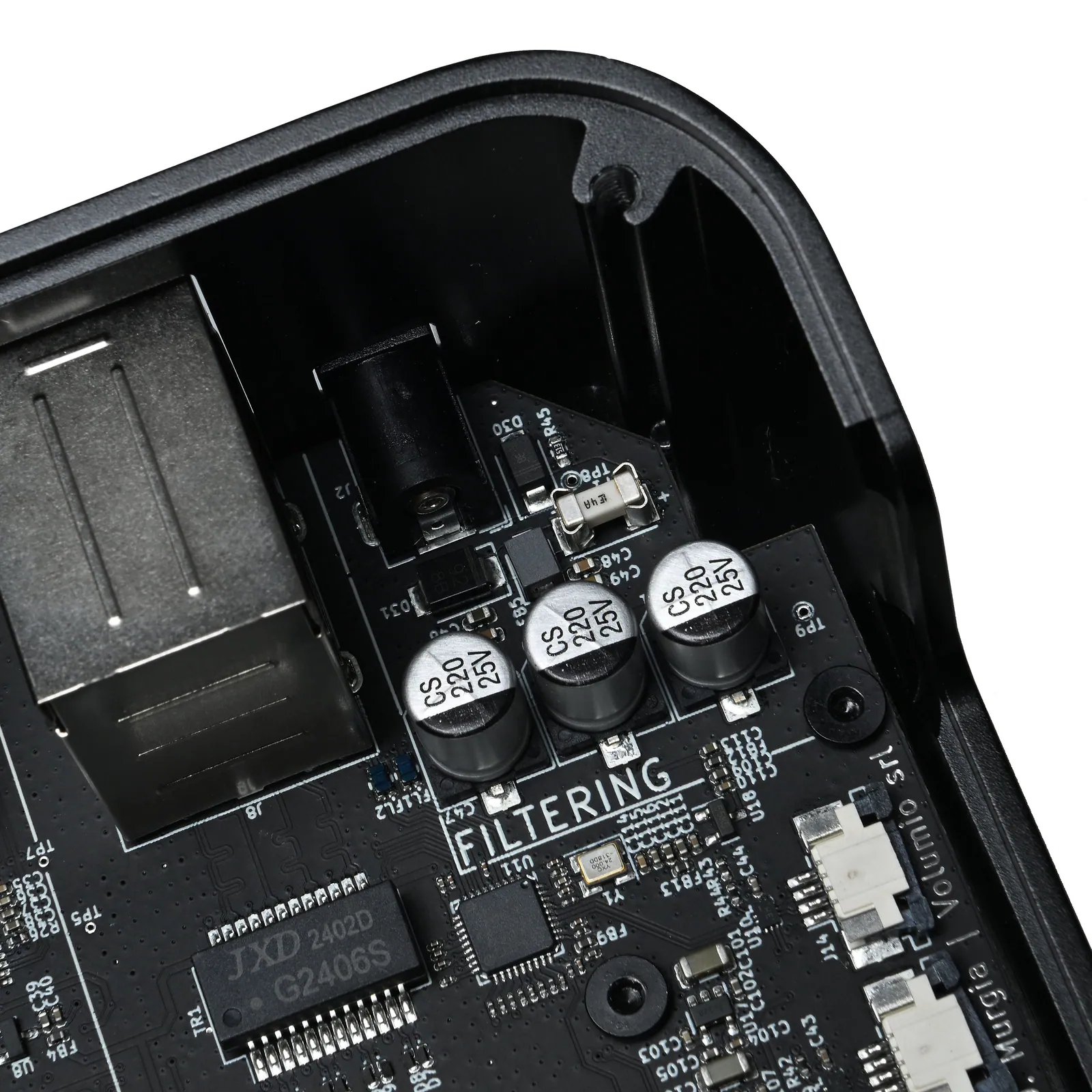

Close-up of the Motivo board at the power input: three capacitors and the section printed Filtering, next to the Ethernet port.
The filtering stage, where the power comes in.
ES9038Q2M DAC
An ESS Sabre DAC, fed by a custom USB bridge developed with Amanero Technologies. It reclocks the I2S and DSD signals for lower jitter. Pick one of 7 DAC filters to fine-tune the sound.
